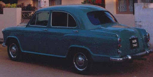

Clicked in 1988...... It's me on the car

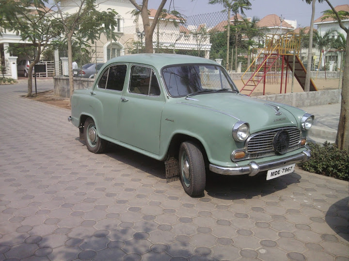

Present condition after re-buying in 2010

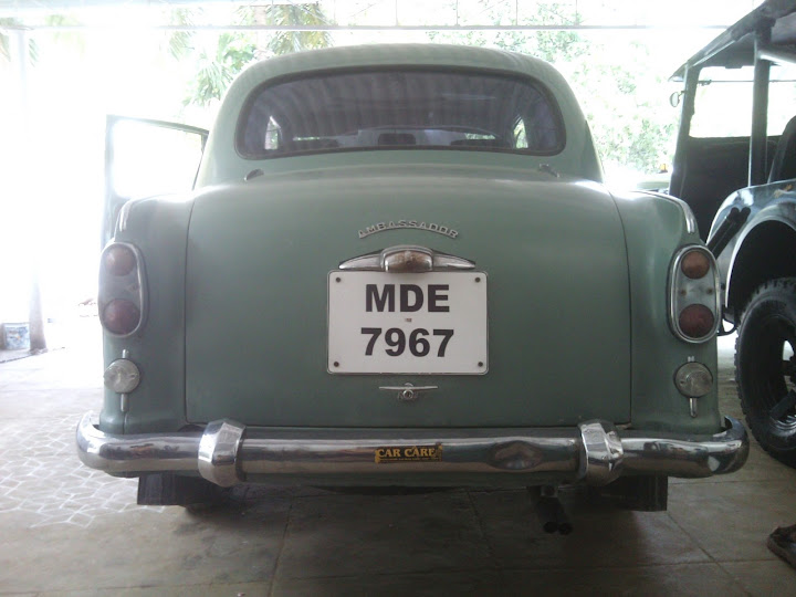

Some more pics in the present condition

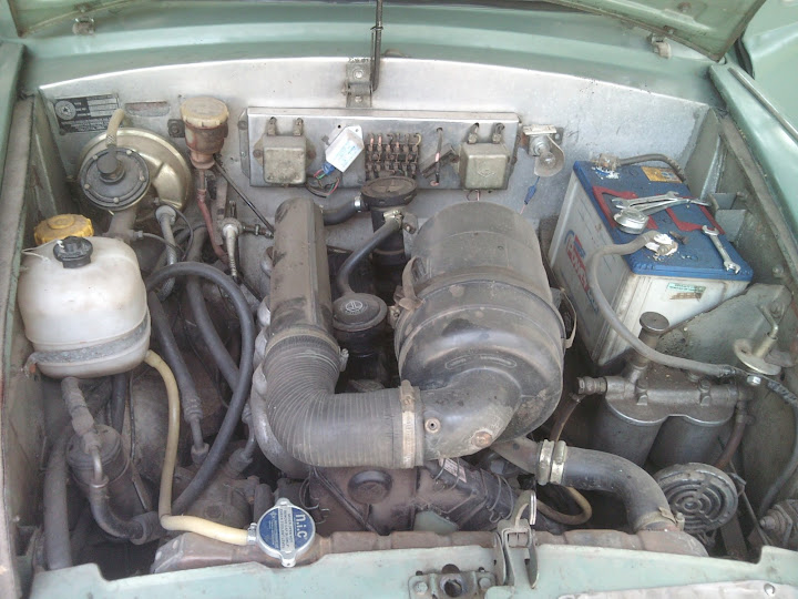

The Engine

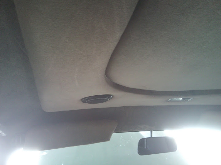

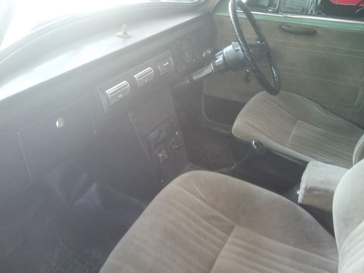

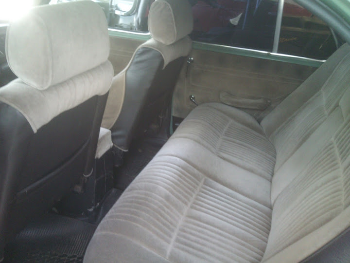

The Interiors

4. The color of the upholstery has changed. Hope that it can be restored by cleaning.
